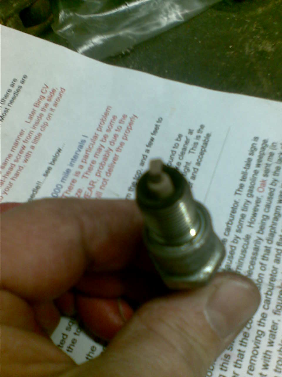

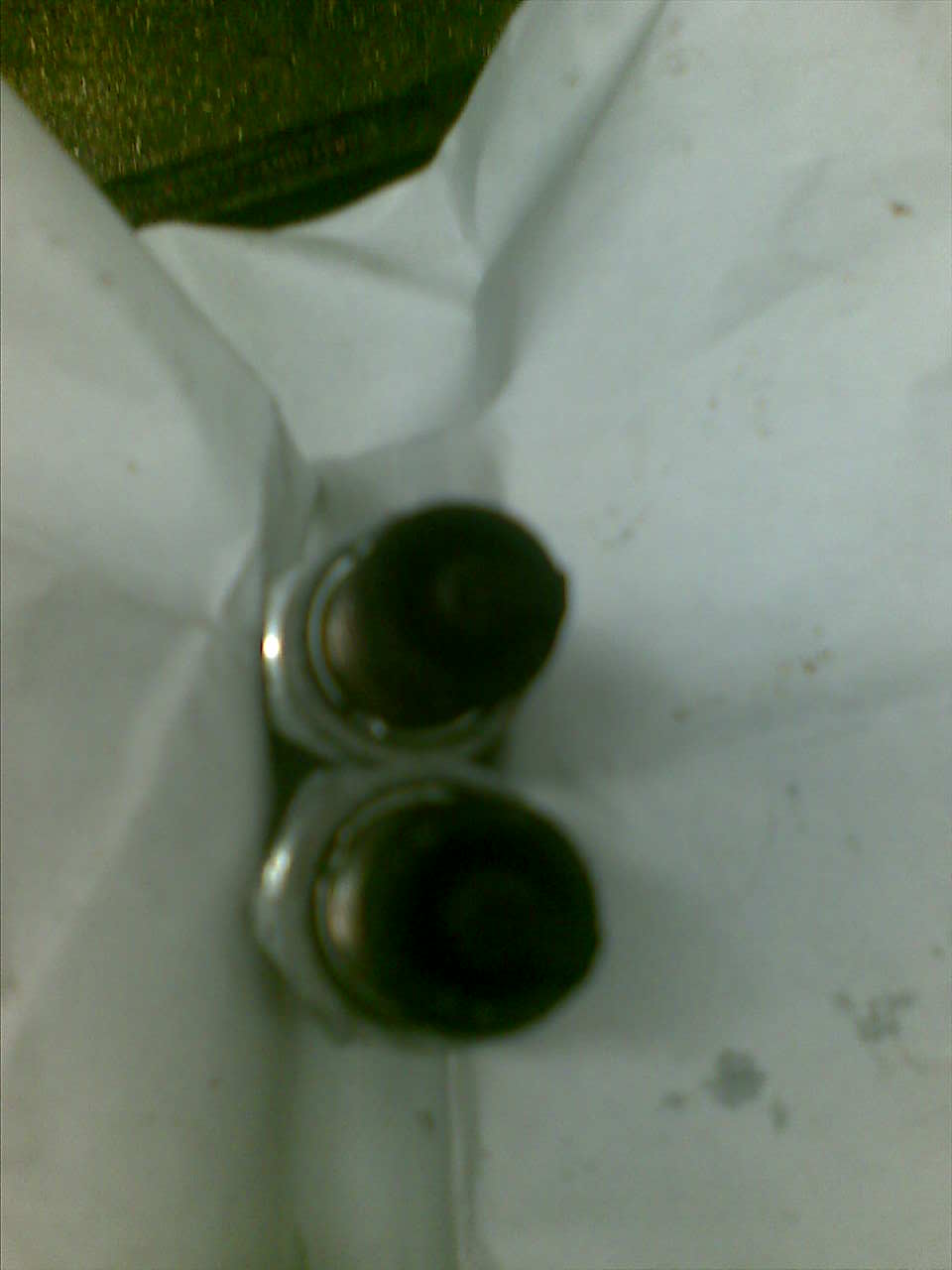

Getting Gertie ready for the big ride ive pulled the plugs and done the valve clearances (they were tight) the plugs are black and sooty but not oily so im thinking of dropping the needles a notch but would the clearances effect the combustion ?.
I used a bit of carb cleaner on the plugs and they cleaded up well.Hanyes says try a hotter plug im on BP6es any thoughts.

Dropping the needles one notch is a big change and at this time of year may make Gertie decidedly cold blooded.  Maybe worth a try though as those plugs do look black. I'll be very interested to hear about the effect it has. A rich Idle mixture and use of the enricher are just as likley to blacken the plugs.
BP6ES plugs are about right for moderate use in fact thay are already one grade hotter than NGK recommend.  I wouldn't risk going any hotter still.

after you clean them up run it at speed then kill the motor coast to a stop and check it. maybe its just rich at Idle or low speed. I usually only check plugs under load at the speed I normally ride.

I think I would try leaning out the mixture screws first, as Barry said 1 notch is a big change.
I would also do a high speed 'plug chop', as JDS says, to see if the plugs clean up.

Ride her for awhile and then recheck the plugs. Your tight valve clearances may have been part of the sooty-ness.

If you have been doing a lot of city driving in cold and damp conditions with the choke on to start and not really getting up to operating temperature that could be contributing to your sooty plugs.  Take the bike out for a sustained run, ten miles over 4500, and get it nice and hot before pulling the plugs again and if possible pull in the clutch, drop it into neutral, and shut off the engine with no compression braking before pulling the plugs.  That will give a more accurate indication of your carb set up.
I wouldn't change anything on your carbs until you have tested it with reset valves.  Carbs are really tempting to adjust but aren't always the first place to start.  And in this case, apparently running too rich is much better than running too hot and burning something up on your trip.

Just rechecked the plugs having done a few "longer" rides all seems ok must have been the shorter journeys and use of choke causing the problem as ive not adjusted anything.
